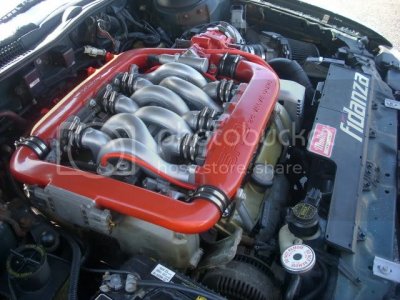

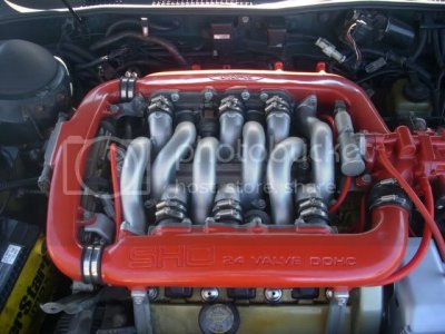

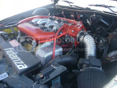

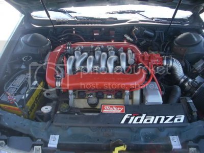

This should Help!
049
047
048
046
Sorry it's a little dirty!
I did the "2- tone " when I had it apart installing my BBB's!
The whole 'Painting Process' cost me about $30 and was done in 1 day:)
