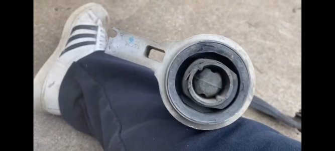

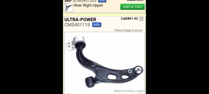

Okay I've been looking at the rear Pivot Point mounting bracket on the Taurus, Edge and Explorer. They each move to Pivot Point to a different position.
Top picture is 2011 Taurus, second picture is flex and last picture is Explorer. You wouldn't mind doing measurements of the thickness and width of the aluminum rear pivot bushing would you? If the dimensions are the same as a Taurus can a kid wouldn't be necessary just changing of the rear pivot bushing to a different vehicle application.

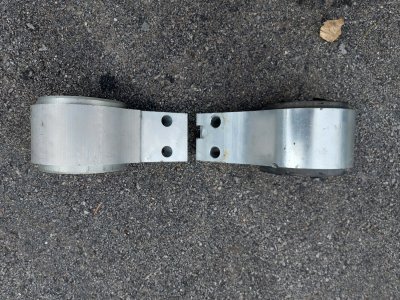

interesting, I actually have a set of the aluminum pivot blocks on my workbench as I am getting ready to fill the voids with 94A urethane...I can get you somethng today or tommorow.

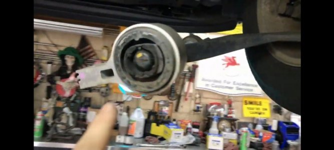

Cool I'm very interested to see what the numbers look like. I found a video of a Pursuit Interceptor getting new control arm and Pivot Point. Actually you something very similar to the flex.

Okay I got the new bushings installed. It went pretty smoothly except for the fact that you need a press to put the bushings on. When you have a 4500 pound car though, all you need is a hydraulic jack to use it as a press. Lol. Don't try this at home kids.
Now I measured the toe before putting the new bushings in. I had had and Alignment done on the car 3 months ago with new suspension parts. Apparently things have settled in because I was 1/16 was an inch toed out.
With the new bushings installed I was now at 0 toe. That's not bad because with the extra power it will tend to toe in. Unfortunately I didn't take measurements of ride height and wheelbase. I do have some earlier pictures though. To my eye it looks like I may have increased the track slightly and very slightly dropped the nose of the car. At least to my eye.
The car feels like it turns in a lot better and rides smoother. Might be my imagination but it seems to launch a little better as well. I will know in a week's time because the last track day of the year is coming up next weekend. If my 60 foot times improve, then it's helped.20211008 163049
Taurus bushing top, Explorer bushing bottom.

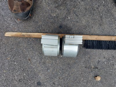

20211008 163224

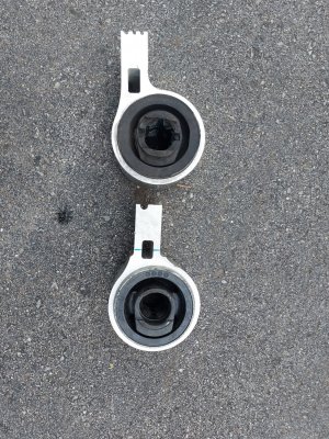

Explorer bushing left, Taurus bushing right.20211008 163256
Explorer bushing left, Taurus bushing right.20211008 163242
Screenshot 20211009 151838 Photos2
Before.Screenshot 20211009 151753 Photos3
After.

Did you have to alter the Explorer bushing at all, or was a simple bolt-in?
The only thing I had to alter was the small alignment pin on the subframe. This had to be removed because the Taurus bushings have a clearance cut, in the aluminum. As far as I know the intent is to keep you from putting bushings for other Ford's in there.
If you look carefully at picture 3 you'll see the cut out on the Taurus bushing and the lack of one on the Explorer bushing.
