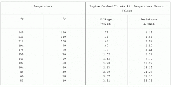

The Ambient Air Temperature sensor is the same electrically as the IAT and ECT sensors. Here are the electrical values for them.
Iac ect voltage values

This is a perfect example of why I will continue in this forum for many years. You guys and girls are a resource of practical and technical information without peer. I can even use my ohmmeter to check the values for continuity. Thank you for all your tips and info. On my car, the sensor is located next to the radiator and A/C condenser. Thus my concern that freon was skewing the readings. I am going out now, before the game, to check voltage and connections. Results later. Thanks again, everyone, for making it easier to keep these great AMERICAN cars on the road.
