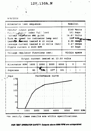

Be aware that reman. units, no matter where you happen to find them, have a high defect rate right out of the box. Before you yank the old one and try to install another put the new unit on a test bench to make sure its output is within spec.

13,265
Yes. Put it on a test bench before you leave the store at the very least before you try to install it. I wound up doing this on 5 different units before I found one that was within spec. for my GenI a few years ago. AutoZone and PepBoys had test benches in the store IIRC.
