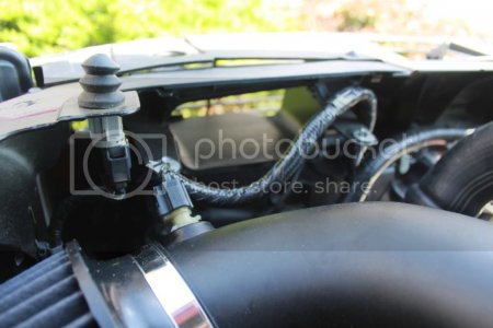

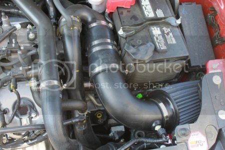

As posted before... here again is my Flex EcoBoost CAI.
IMG 0729
I too have removed grille back panel that both SHO & Flex have. Much better air flow into stock oval designed to funnel air to filter. My engine temps are rarely over 3 deg variance from 190, and usually a couple degrees on the low side of 190.
IMG 0734
