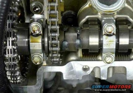

the part that he is observing thru the oil fill is the end of the left hand exhaust camshaft. it has a bump/out or whatever you want to call it with two flat sides for use of a cam position tool. this is what gives the appearance of a wobble. the wobble on the camshafts cannot be seen without removing valve covers.
ricky
Nov 27, 2002
231
sharpsburg,nc
good picture of front cam, back of front sprocket and secondary sprocket. nice welds. the "wobble" effect maker is on the other side of the front sprocket.
