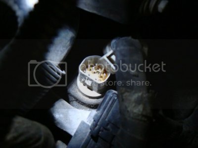

Well update... there was some red fluid (rust?) in the bottom of the transmission connector. Cleaned it up with Q-tips, then sprayed a little WD-40 and then cleaned out again with Q-tips.
Got pics, going to put my porter intake back in the car after the paint dries. Then going to check PCM connector.

Connector full of red goo
DSC05499
I think I did this to myself as I like to keep my engine bay clean and possibly got water or spray foam in it.
