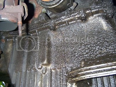

If you own a SHO, you might as well get used to changing starters. I have resorted to having a spare starter for each car.
When one starts to labor, I can swap it out, take it apart, clean it, reassemble it, and put back in the "spares" pile. I have the "rebuild" process down to about 10 minutes and really don't need the spares anymore(eventhough I'll keep them).
If your oil cooler is leaking, it leaks right on to your starter, bringing all kinds of dirt with it. Simply removing the starter and cleaning it in and out will usually bring it back to life.
If you go to change out your starter and your block looks anything like this..your oil cooler gasket is leaking.

hah my whole block on the passenger side looks like that lol. (cam seal) my starter is original and still works perfect even with -40 C weather WITHOUT a block heater... i guess there is a bad batch of starters out there for a few years lol.
