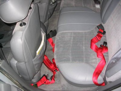

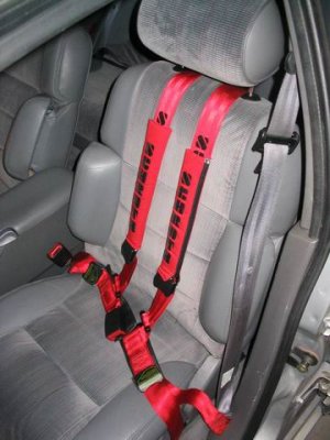

Alright i searched muliple times and have yet to turn up any results for anything to do with 4 point harness. I have one that i want to install but wanted to see if any one has pictures of their own. I know the shoulder harnesses have to be at a certain angle and i tried mounting the should points to the rear lap belt points but the harness was to far up on my chest. so post pics please!

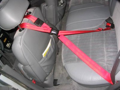

Strictly speaking, the shorter the shoulder harness the better. My Schroth is made specifically to use the anchor points of the rear belts, but the best thing to do with a four-point is to have a harness bar behind the front seat to anchor the shoulder belts. Usually that means that you need a roll bar or some substantial means to anchor the harness bar.
The Schroth is made for the case without a harness bar, but it's definitely a compromise. Whatever you're doing, be sure to educate yourself to make sure that you understand the issues. Installing belts, etc., is serious stuff and there are definitely tradeoffs that should be considered.
