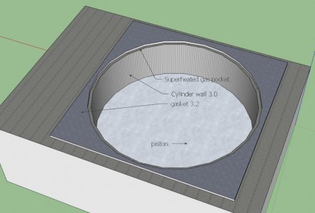

There's going to be a ring around the cylinder...
In some places (most places, if memory serves) the combustion chamber does not meet the cylinder wall. This means there will be a gap at the top of the cylinder. Even if it's sealed properly, gases and soot will accumulate and superheat that area, probably blowing the head gasket.

you can run 3.2 head gaskets in the 3.0 engine, but it is not a good idea. you will have a small ring of air (approx. .060" by the thickness of the gasket) that will eventually fill up with carbon. some day, a chunk of this carbon will come out of there for some reason and end up somewhere that you do not want it - i.e. under a valve, in the spark plug, bouncing in the cylinder, etc. - you get the idea.
