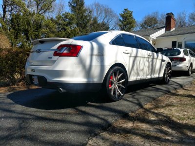

I am using the H&R springs first off. The 20 x 9.5-30 fits fine up front with no issues, however I'm fighting the rear-same size. It's rubbing on the inner plastic fender well on the left and right side of the tire-not the top. I tried to correct with a camber adjustment, but didn't like the look of the angle. Currently I am grinding some of the plastic away and I put the camber back. I can see why SHOdded's offsets work because the wheels don't stick out as far. A 20mm offset would be pushing it. Mine stick out past the front fender about 1/4". A 10" wheel with a 20mm offset would put it out another 1/2". That would be no bueno.

275/40/20. Rubbing on some plastic is no big deal. That can be fixed. Rubbing on a shock or some other piece of frame work would really be a challenge. i lucked out. I'm not saying at all a 20 x 10 or 9.5 with a 20mm offset would not fit. Just letting you know what I'm dealing with. After the snow melts once again, I'm taking it out to see if I fixed it. Try to stay as close as you can to the stock 38mm offset.

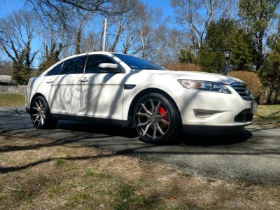

Hey Jason did you ever find out a solution to your wheels rubbing? I put mine on today and the fronts are rubbing on something. Tomorrow when I have an extra hand I'll be able to find out. I have access to a lift so I'll be able to have the car in the air while someone drives it. I'll have an answer tomorrow but just seeing what you ran into.
Corey Sig
2011 SHO PP
Jun 5, 2015
71
37
MD
Just an update... Tires were rubbing on the front... They were rubbing against the strut.. Advance is bring a 5/16th and 1/4 spacer. Going to see which one is gonna work for me or not.

It was rubbing on the inner fender in these 2 places on the rear. Used a die grinder and a carbide bit to knock the plastic corners down. Filled the void that was created with epoxy.

I don't think mine was rubbing there I'll have to check again. Sucks the front is rubbing but I think a 1/4in or 1/8in should fix it.
