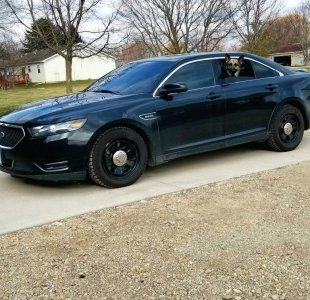

Factory 18 inch steel interceptor wheels fit. The ride is smother, but you can tell the sidewalls flex in a corner
Acceleration will not change.
Thanks for the info. Being in Colorado the paved and gravel/dirt roads can get rough. 20" rims don't make sense here. Do you have a good source for the interceptor steel wheel?

I got my interceptor wheels from a wrecked PI sedan in a local salvage yard. They had 3 complete sets at the time. Car-part.Com can find local yards with that specific wheel...it's what I used.

I know it’s been a while, but the car had about 52,000 on it when I posted. It now rides on 17” mustang rims and the ride is improved. The suspension is definitely the biggest problem with the ride quality. I will be goint to coil overs at some point this year. The tires are 225 series and much easier to spin on dry with tc on. At 6500 ft elevation plus it wasn’t a problem on the stock size. Plus I reduced my top speed to 118 per the much lower tire speed rating of the larger sidewall.

I am interested in using the 17" PI black rims on my 2015 SHO. Thank for the infor, they have been hard to find. What tire size are you using on the 17" rims?

Will 255/55r18 fit on the PI wheels? I found a deal on brand new Michelin Alpin's for $29 a tire!
