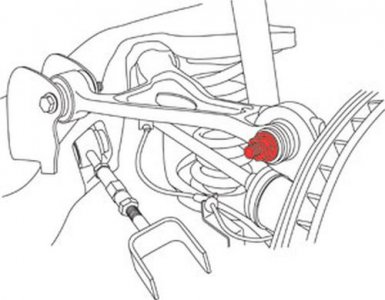

How did you know that THAT is the one? I couldn't find a number anywhere!
I installed H&R about 4 years ago and at that time there were no camber bolts available - however, there was one camber bolt that was the correct size except for the length - it was only long enough to get like 3-4 threads tighten in the nut! But, after 4 years I've had no issues but it's always on the back of my mind that it's not 100% a correct part. The camber bolt I bought then was the 81280. Since then they came out with the correct size for our cars and this is the one - 84130. Several other SHO owners have installed this bolt and say it's the right size, length, etc. I just ordered and received mine - time to install now.

I haven't looked at the suspension yet, so this might be clear just by doing that. However not being in a position where I can do right now; do I need 2 or 4 of those bolts? Are those needed just in the front/rear, or both?
Just the rear - one for each side.
84130 Camber Bolt
