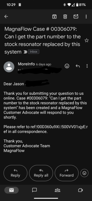

@Ta2dResqr you are right, I did find info and they advise against it. I recently email magnaflow for their Taurus cat back exhaust. In a post elsewhere, maybe this thread, they confirmed the mufflers in my signature and the X Flow resonator in that kit are the components plus pipes and accessories for $1500 thought I spent 300 for two mufflers and that X Flow resonator for a $200 more is all that their kit is.
That being all said - my best guess since I have seen people post that component makeup kills their drone. It's possible that X pope though for performance does nothing could be canceling the drone.
I will and going to cut out my Flowmaster FXs and replace for that mganaflow X pipe muffler/resonator to see the different stay tuned.

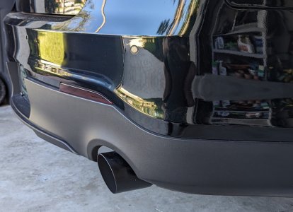

Yea, I've considered changing the mufflers out to something that's still very quiet, but has different tip options. The chrome tips on the Flex get dirty instantly, and I'd rather have something in black probably, but haven't really come up with any good options. Also, a slightly smaller muffler would be nice as sometimes the exhaust hits the hitch on the right side when coming out of parking lots that have extreme angles.
kryptto
Mar 24, 2023
3,196
2,066
South East, Florida
I painted the end of the muffler flat black. Not in picture.
