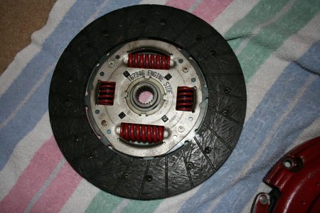

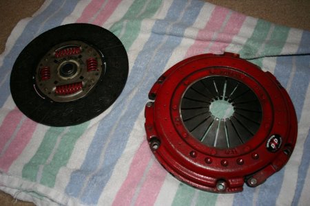

Also, a member messaged me and says he has a Southbend clutch he no longer needs but he isn't sure of the actually model (stage "x").
MZEBLh
L7Hnyh
8p5IFh
Anyone recognize this? The pressure plate has "Valeo 339847 MF2 5L11" stamped on it and the clutch (engine side) has 167346 marked on it.

It's either a stage 1 or 3, assuming it's a Southbend disc. If both friction materials are the same, stage 1. A stage 3 will have an organic disc on the PP side and their "feramic" stuff on the flywheel side (according to SHO Source's website).

^Look at SHO Source's pictures. Every stage has a DXD sticker, at least in the pictures. If it was really a DXD (stage 4), it would have a 6-puck kevlar disc. The stage 2 is kevlar as well, but not puck style. The disc pictured above is definitely organic on the one side we can see, so it has to be either a stage 1 or stage 3.
Upon further reading, the "feramic" material would be on the flywheel (engine) side if it was a stage 3. The one pictured above is organic on the engine side, so it must be a stage 1.

Alright, seems like you are correct, thanks man, I owe you a beer.
